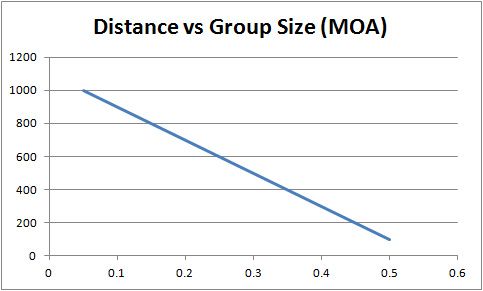

There is a linear relationship between distance and impressiveness of group size, where distance increases impressiveness also increases. Expressed as a formula where impressiveness is expressed as a function of x and mx is the slope of increasing distance, the equation would be:
f(x) = mx + b

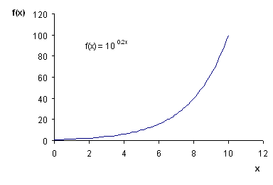

Following this, there is a secondary effect with a strong exponential curve. Once we have solve for the f(x) impressiveness factor, we can calculate the likelihood that the underlying group size would be verbally recounted to others. As you can see, with the factors of increasing distance and decreasing size there is a rapidly increasing incidence of "bullseye summarization", or BS for short.
Combine this aggregate auditory data that the average shooter encounters with the underlying experiential knowledge that is the basis for all shooting and reloading practices, and we have a solid foundation with which to calculate the direct relationship between distance and the resulting group size in minutes of angle.
m = (y_2 - y_1) / (x_2 - x_1)
The net result gives us concrete proof that the phenomon is indeed true.

I have talked to a few guys who claim to hit anything out to 300 yards with their 17 HMR's, yet when I shoot with them they can't seem to put five bullets into an inch at 100 yds. -- The ONLY explanation for this must be the "sleeping bullet" theory. Lemme know if there's anything wrong with my logic. :pjd
I believe I have found a mathematic explanation for the phenomenon.

I would suggest (Now here me out) that the measurement of MOA doesn't relate.. A Minute Of Angle ten shot group at 100 yards doesn't relate to a minute of angle (10.47") ten shot group at 1000 yards.. What I feel I and others are actually suggesting about certain high BC bullets is that at distance they are out performing the MOA mindset that we seem to measure performance by at distance.. If my gun and load combo shoot half MOA ten shot groups at a 100 yards but frequently shoots sub half MOA (5" or less) at 1000 yards, is .5"-5" somehow defying logic? I suggest that it is common and that many bullets perform well at distance even without mind shattering small groups at a 100 yards..
