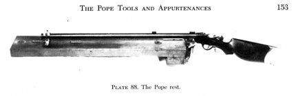

100 plus years ago when the barrel was laid directly on the mount for bench shooting, part of the process was to strip the rifle down to the action and barrel, suspend the assembly, tap on the barrel and find the dead spot. The place you could tap and get no ringing or vibration.
This was where you place the barrel on the rest, or attach the front portion of a “machine rest”. Adjusting the position of the clamped on front rest fore and aft can dramatically change group size. It was literally tuning vibrations like a fork.
Anyone who has ever shot with a barrel resting on a sold object has experienced the jump of barrel on recoil. Watching a match shot off cross sticks will quickly show the new shooters. They are the ones whose rifle jumps uncontrollably.
Here’s a machine rest of the day. Setup correctly the rifle would slide straight back.
Modern example of the same style rest. The rear mount is a reproduction with an updated front mount on the rifle. Period correct front mount is shown.

Man, that is one beautiful rifle/setup. That pair of pics to me are just cooler than cool. Thanks for posting them.
