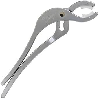

You need the pliers below we were issued in the Air Force. That way your lock rings will not look like a herd of beavers were chewing on them. ;) Aim High Air Force
Crescent 52910N A-N Connector Pliers, 10-Inch (with "soft" rubber jaws)
https://www.amazon.com/dp/B00170RES8/?tag=accuratescom-20
The above message was brought to you by the "Society for the prevention of cruelty to lock rings" :rolleyes:

Below are the pliers I have had and used since 1974 to use on my dies round lock rings. The hard rubber inserts have been replace several times and angry beavers or slip joint pliers have never marred any of my lock rings. You can also see my favorite type die a Forster full length benchrest die.
