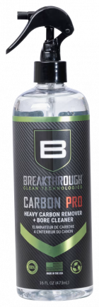

I`ve tried ALOT of concoctions in the last 50+yrs, but as of lately, i tried the Breakthrough "Carbon Pro". I threw out everything else immediately in the garbage after i saw how good it worked. Not only did this stuff clean out my built up carbon, it also cleaned out my gun cleaning cabinet.
I soak a cotton patch, let it sit in the chamber 5 minutes, twist a plastic bore brush into the chamber, no more carbon.
I bought BT-Carbon Pro at BassPro, but have since found it through HomeDepot a little cheaper. I can order it on their website, then go to town and pick it up when it comes in. For me, its easier to drive to my local HomeDepot 10 minutes from my house rather than drive 2hrs (to an from) to basspro.

That’s odd that Home Depot sells this.
I bought some of this to test but it sat too long in one place and wife chucked it. How does it compare to bore tech? I have a small bottle on the way to try
