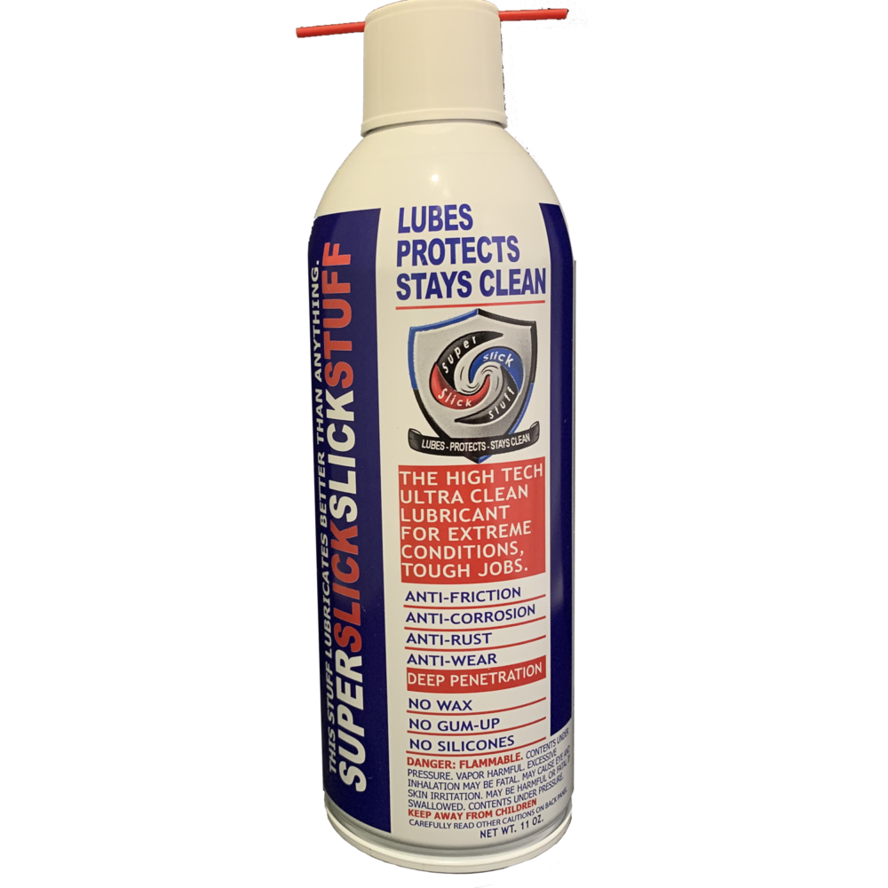

This is my other favorite for brushing. Smells better.
