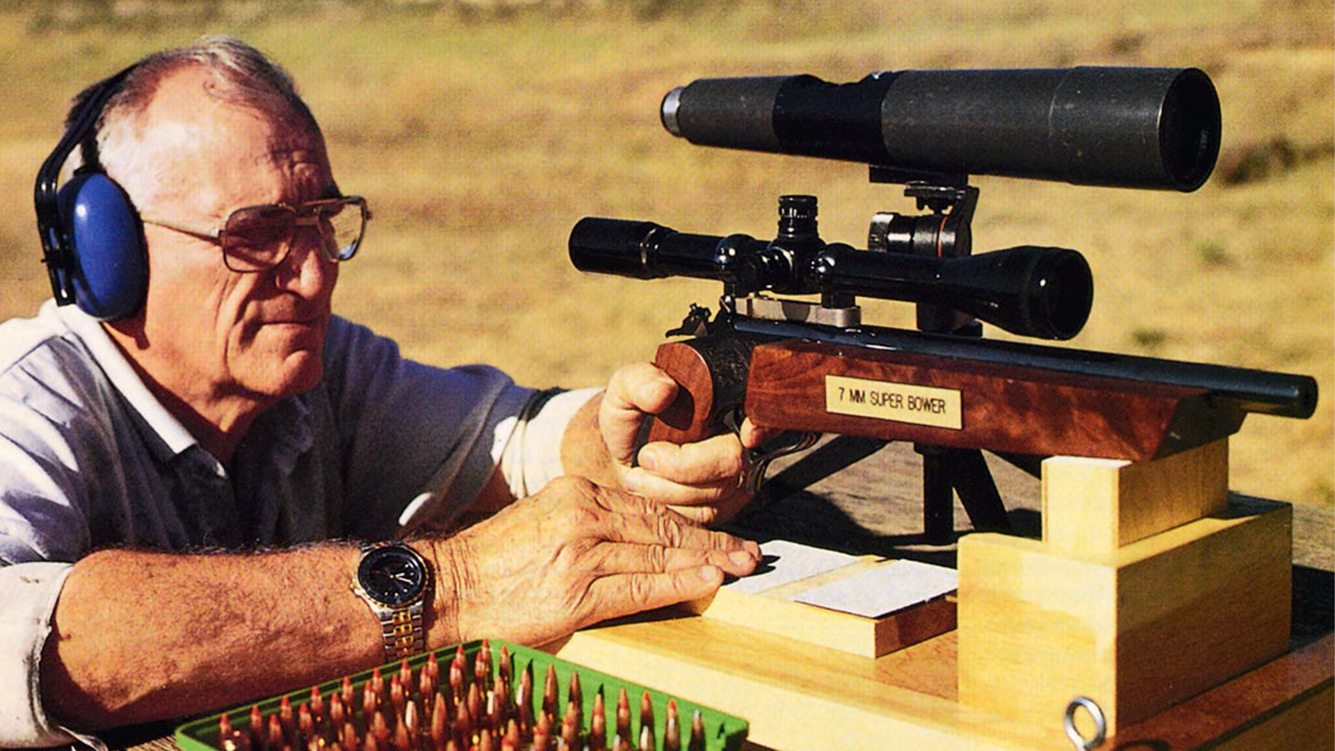

I agree completely but persistent fieldwork with a setup can build not only confidence but consistancy
100 yds has gotten to be a 'chip shot' with a few of my barrels
