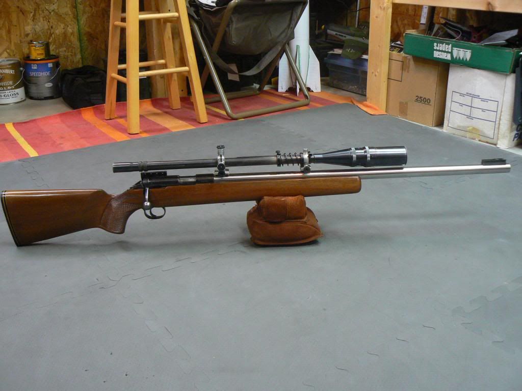

The other 52D I rebuilt and I will post a picture of that rifle has shot many sub 1/2" groups at a 114 yards. It's shot consistent groups in the .1xx's at 50 yards. It's not a bench gun either but rebuilt as a standard 52D in. D stock. Tell me it's not good enough!?

STGW77, Here is a picture of the other 52D.
Barrel is a full 28" Winchester profile. This gun or the International rebuild you cannot do anything wrong with when it comes to shooting them. The International rebuild only has 45 rounds on it to boot!
