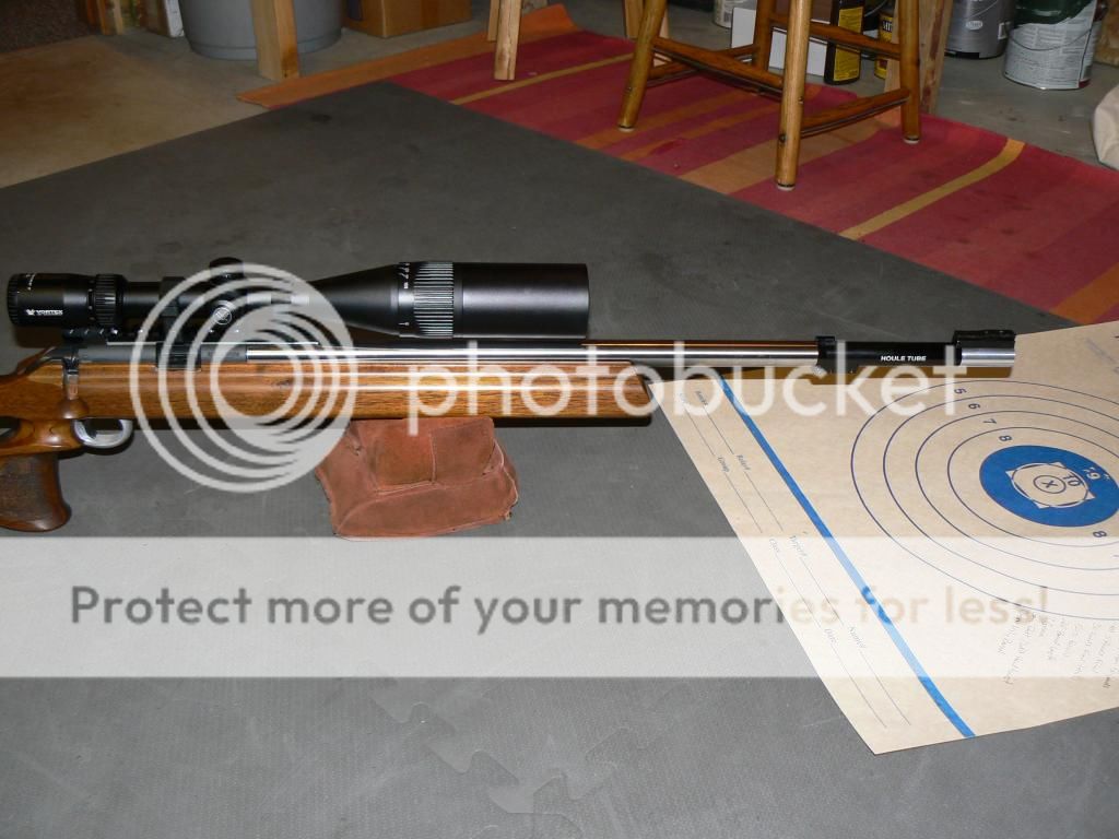

I just finished a 52D/International rebuild and have done a little shooting and velocity testing with barrel lengths.
First time out with it about a week ago. Put 30 rounds thru it. After a quick zero on the scope and the gun and scope and ammo tracked perfectly. My last two groups at 50 yards measured a .103" and a .114". Took my last 5 rounds of ammo and put some elevation up on the scope (little to much and was going off of memory on the come ups) and shot this one 5 round group at a 114 yards. No break in etc....ammo was RWS R50. Didn't sort the ammo etc... Finish length on the barrel is 22".
Gain twist rifling, 16.25 to 16 twist. 8 groove, left hand twist. Mimics Popes rifling. My spec. match chamber. The barrel is c.m. steel. Eventually will get blued. I bedded the stock and made a 52E style recoil lug for the receiver. The contour of the barrel is a modified palma contour.
