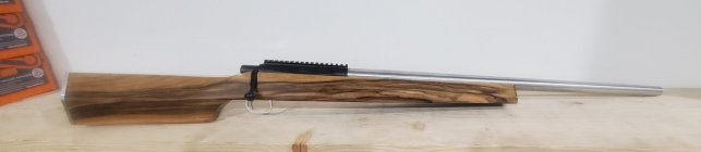

This LV will be sweet after a little dye and clear...View attachment 1435070

Its way too heavy for a lv gun. Its getting inletted now though and going to be nice
I thought you were going to cut the bottom of the stock off to give it the angled bottom which I would have thought would take off quite a bit of weight.
