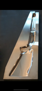

Roys stocks have a carbon fiber triangle the full length of the stock. Its run down the center so you can build the stock out of very light wood. He also has the barrel channel and forend lined. I like that better than the carbon shell. Once the tape is removed and clear is polished out it will be under 22oz. IMG_20230429_090518.jpg
