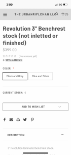

I posted the stock shape rule above
That rear stock is going to take a ton of work to be light enough and to be legal. Ill get one from you and see what itll take
The laminated baby tracker i had years ago had deep cut outs in the forend the butt was really slim in width all to get weight out
it ended up cracking on me in the wrist area it was so narrow
all that said it did make LV with a panda and no tuner
So one of these may not be to bad to get to a HV once you get the rake fixed
