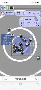

Totally agree with you. This is a test with my 6BRX and 105 gr. bullets with only 1/2 increments from in tune @ setting of 6. 5.5 and 6.5 began to move the bullet around and off the 1/4 inch dot.

Exactly. On the E C T/B the increments are only @ 1/8 inch apart. It didn't take very long at all for me to realize that down and out and up and in was the correct way to turn the tuner to keep the load in tune.
About the same as mine but the radius is different where the numbers are engraved...which kinda makes it apples and oranges. Actual tuner travel on mine is essentially 1 mark = .001"
32tpi and 32 marks around it.
This is for my standard tuner. The new lighter model is different. It's amazing how much difference it was. I only use 10 full numbers on the light model vs 32 on the std.
Maybe and maybe not. But in theory, yes. You need to know what the value of each mark is on the target, from in tune to completely out. Again, on my tuner that's only 4 or 5 group shapes(marks) to recognize and keep up with.
Yes, I would imagine each make of tuner has a little difference in the numerical layout. Ultimately ,one can get a feel of the tuner and tune each load to satisfaction.
I guess on the E C T/B one would need to check between each hash mark to tune even finer than just each mark.
I generally don't mess with half marks. The value has to be enough to predictably change the group, to read, in conditions. In perfect conditions, I can sometimes see a half mark on paper but if it's not enough to make a clear change, then how can I know that I didn't go a half mark the wrong way, for sure?
