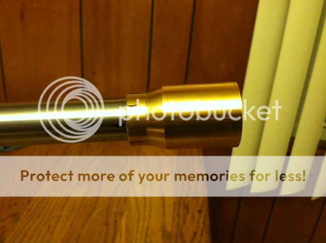

Finished my tuner today! I made a tight slip fit threaded bushing that is simply heated, and loctited to the barrel. No turning or modifying the barrel. Tuner weighs 8 oz. went to the range in horrible winds, set out some flags amd started tuning.
With less than half a turn I found my best group. Horrible conditioms but it shot very well. Tune I settled on put 4 in one hole in the teens but last hole put it in the high 2's . All grouos but one were still sub 1/2" groups.
Will post pics when I get home of the tuner. It utilizes o rings to keep it tight and absorb any vibrations from the thread to thread contact.
Real excited about this season. Now in my mind, I know it is not my rifle or load and will be all my fault for poor shooting!
This rifle shot very well before tuner, but even better afterwards. All my rifles will wear tuners from now on

Tony,
Under the large diameter portion is another brass sleeve . Large diameter is threaded as well. The small diameter is not but has three internal grooves for three orings. The sleeve is brass with only about a thou maybe two oversize. I use the thicker green loctite made for cylindrical assemblies. If you use stainless on both parts, a loctite primer is required because the way it cures.
I would put the sleeve in the rear portion if I did it over again so I could remove the tuner. To further dampen vibes you can wrap the threads in a wrap of teflon tape.

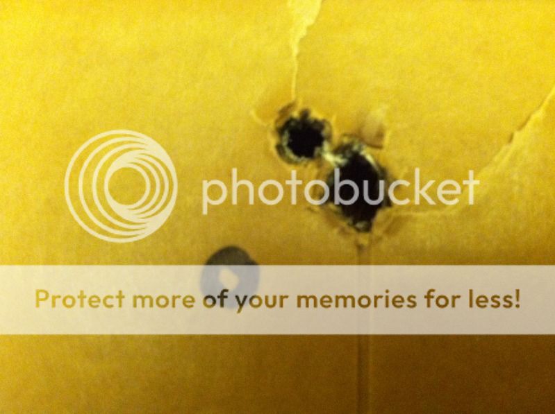

This was my last 5 shot 100 yard group today. I started tuning flush and turned it forward. Suspect I could have went either direction and found a tune. I really believe if I had payed more attention to the wind, that would have been one hole.
If you use a sleeve put it on the rear portion of the tuner so you can remove it. I will redo mine.
