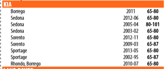

You should, 95-115 depending on brand (car or truck).

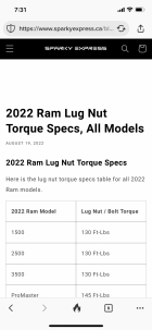

Probably even higher than that. Light duty Ram truck wheel lugnuts use 130ft-lb (176Nm). I know because I just left the plant 30 minutes ago and I had to check the torque for lugs for a rework procedure.

I'm old and it has been a LONG time since I was in the shop, I know some of the newer stuff has increased the amount of torque required to hold the wheels on!
No, that’s not accurate. Aluminum alloys have been around and popular for much longer.
Im just saying wheels and tires have changed alot since that chart came out. My wifes new telluride has 20” wheels and takes 110lbft of torque. The mechanics use torque sticks. Heres a chart for a typical ram these days
