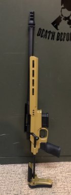

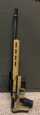

@joshb theres a guy on a Georgia specific forum that I do training with. He’s a smith and firearms trainer in fighting guns and long range shooting. He’s always assisting guys in finding the cheap but quality type stuff, and he does it solely to get them more into shooting. Well, he’s building a custom Howa in 6.5 grendel as a long range, compact gun. This is what he has so far. He’s putting a 2.5x20 NX8 on it. The guy knows his stuff and he really likes Howa.
