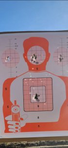

I have been playing with a g20 for a bit changing stuff on it trying to figure out brass life and ways to improve on brass prep. And what all is really needed to make it all work with hot loads for reliability and longevity. Anyways i have been running 200 grain hornady xtp, starline brass, aa9 powder , winchester primers. Current load is running 1200fps range. Very accurate will be testing Montana hardcast 200 gr bullets next hopefully they will hit the same velocity with accuraccy and reiability. Target shot at 15 yards standing no bags or support used.Screenshot_20250116_205632_Gallery.jpgScreenshot_20250116_210058_ShotView.jpg
