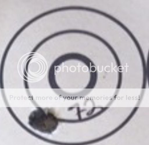

Forget about all the "whys" that could form those two groups. Forget about the loads, wind, gun handling, bags. Theoretically speaking say they were shot in identical conditions. Which group would you go with? The one on the left or the right and why?

Left. The right group is trying to print on an angle, and the holes look like shi#*. This load obviously needs work, where the left group is trying to put them in a hole, and will be, in short order.

Excellent! The group on the left looks as if whatever wind was present was pushing the bullet around. The group on the left is cutting the wind a little better. If I was tuning for what I thought would be a windy day. I want the one on the left.

If we were looking at a situation where all other factors were perfect, my answer would be neither. I would keep looking.
You my old friend are missing the learning point! Maybe this will help. Now with these two groups which do you choose? Top or bottom?
... Lets say the conditions are ideal. Calm to very light wind. ..

OK if we assume that horizontal is because of wind, which can be read better, and vertical is the result of tune, given that the wider group is not a straight line, I would go with it, because a shooter can improve his flag reading, but there is nothing that he can do to compensate for a load that has more vertical than would be competitive. Neither load is short range competitive under perfect conditions. This was written before you posted your groups. From yours, it would be a coin toss, but I would probably go with 72 for the same reason on a much smaller scale, and yes, yours are competitive :-)

Tony would be so disappointed in you. No matter how well you read the flags you can't keep up with a wind sensitive load. Over the course of an aggregate I think the bottom one will work better.
This is why I don't really like discussing the finer points of tune based on scanned images, published on the internet. Discussions always lack sufficient information. Wind sensitive, or condition missed? How in the world would someone know which it was without a video of the flags shot as the groups were being shot? Both of you have a lot more information than those you ask who only have the pictures to go by. No one reads wind perfectly all of the time, which means that it takes a lot more than one group when small differences are being evaluated.
Don't forget that wind (depending on angle & velocity) can add vertical to a group also.
I wonder what the groups would look like given the foregoing wind condition with the loads already having built-in vertical??

That's just it Boyd. I shot those groups. I know where the flags were and I know where the crosshairs were at when the gun broke and I called my shots each time. Thats every shooters job at the bench. The goals is to read them better then the guys you're shooting against with a properly tuned gun. Last year I had 18 first place finishes and shot 16 teen Aggs. So, If you find that most of your groups are predominantly wide, you may want to rethink your tuning regiment.
A little bit of vertical at 100 or 200 yards will shoot better at long range than one with no vertical I have also seen this when I used to work up loads at 100yds, now I only do it at 600yds just because it's a long ways to go shoot at 1000. It's the best way to see exactly what happens when you change something.
Well, I disagree with needing to know what the conditions were to be able to read the target, somewhat. Within reason (decent conditions), Looking at bullet holes and group formation without knowing conditions, should tell you if the gun is shooting. In short range BR, tune is far more important than condition reading. I've done a bit of 600 yard BR shooting as well, and find the same thing.
