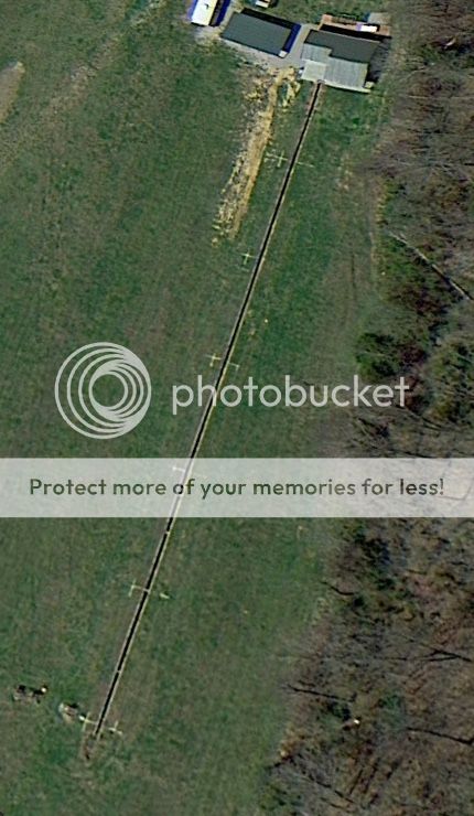

I can shoot in near zero conditions anytime I want. I have a 100 yard long a ditch with concrete walls. It's about 24 inches wide and 4 foot deep. It works much like a tunnel without all of air evacuation problems a tunnel has. It's a great tool for a lot of things but it's not where I tune my rifle.
Bart
