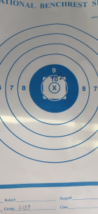

3 shot groups at 100yds, Pic. 1 is Lapua brass and 2-4 are with Alpha:
Picture 1 is my go to charge of 30.46gr of H4895. Outside to outside edge = .3135"
Picture 2 is 1 grain less (29.50 - possible mid node? or an odd pocket node) Outside to outside edge = .2515"
Picture 3 is 29.70
Picture 4 is 29.90
The way everything felt it seems like it will come back around as I increase powder to my go to load. I will chrono the 29.50 to see if it is reproducible and then see what the speeds are and where I can go from there. My barrel likes the 3009-3015fps range. I will not use the Alpha brass in matches until more testing is done, but I think it will end up being fine.
