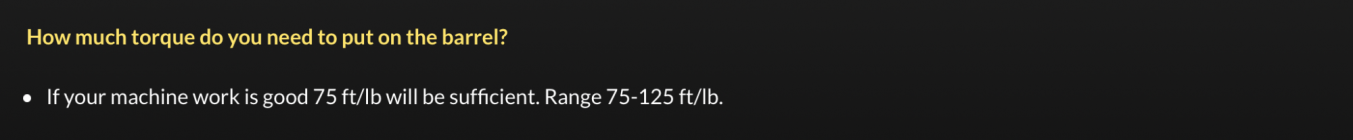

I'm looking for opinions on how folks put barrels on actions... Talking about SS actions and SS barrels here.
Question is about lube and torque value, but mainly the torque.. Do you snug them up by hand or quite tight? Torque values if you use a torque wrench...
Jackie, I believe in the past you decided somewhere around 125 lbs ft... If I recall, Gene agreed with that.
Anybody ???? TIA!
I would lube the threads and contact surfaces with Molykote-P37 and torque to about 100 lbs.
This is kind of like action screw torque in my opinion. If the bedding is good it should not make a difference so long as its not loose. I dont use a torque wrench I use a t handle. I just put them on tight. Same goes for action screws. The lug nut reference is what I tell customers and if they want a value I usually say 75-80 pounds. Do I think there is a difference between 75 and 100, no. But I wouldnt do less than 50. So far as grease, again Im not sure it matters I just use the one that has been used on the rifles that have broke the most records, lol. Just more of a superstition. I have not done real testing in this area, I just am going with what I know has worked for some exceptional rifles. If the machine work is good, a barrel torqued to 75 will feel like it was at 200 when you crack it loose. Im not concerned about any movement in the joint.

Decades ago, with the typical 1.062 diameter threaded joint, I settled in on 80 pound feet with a thin coat of anti-seize, with emphasis on thin.
Like Al Nyhus, I also place a witness mark with a sharpie pen to insure the barrel did indeed advance on the action After a firm seating.
I have also cured more than one ill shooting rifle by simply tightening the barrel.
I really don’t argue points such as this. If a rifle is shooting up to it’s capabilities, over tightening the barrel will not enhance it’s capabilities. However, if it is not sufficiently tight, the rifle will never shoot up to the capabilities of the assembled components.
I had some grease dry out on my P. dog and Ground Squirrel Rifles that I shot very hot, very often, so I like a high pressure, high temp moly grease.
Another issue are Non trued Remingtons with factory recoil lugs, I torque them 80-100 ft/lbs where headspace does change a tad, and I finish them by hand.
Feedback would be nice on this "changing headspace" issue which seems unavoidable since the action face is not square, nor is the recoil lug. Seems like a shrinkage of headspace of up to .002 is the norm, and this is what I plan for.

Amen, Jackie. As Mike Ezell posted....once it's tight enough, any tighter is just tighter. It's the enough that we have to determine for our own situation. The camera angle makes these marks appear further apart that they are.
Can I get a witness???? ;) :D
If they are slightly closer then they look. That is about what I get torque to 70 ft lb.
