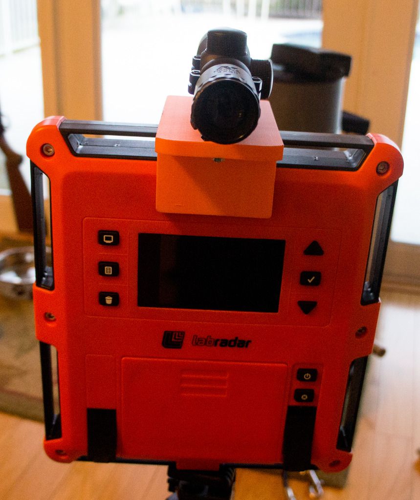

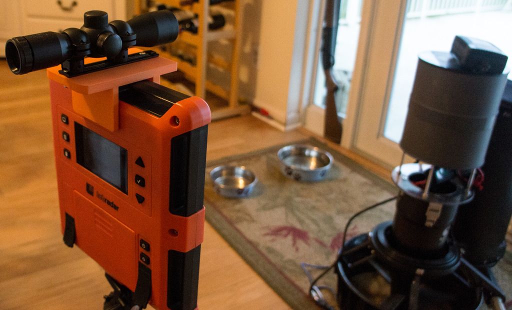

way overkill aiming device. friend had a 3D printer and made the bracket, put an $18 NC Star scope on it.
I went to a hardware store and bought an aluminum tube about 12" long. Just set it on top and stand behind it, and set your aim to the target. Very easy. For aiming it works great. A straw may work unless it is windy. Doug
