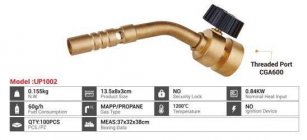

I am thinking about providing torch heads with the unit in the future, to ease up the setup. But I am not sure about bottles available in US - in terms of connecting - I can supply ones with CGA600 thread.
Can some of you please tell me are those common/available?
Thanks
Not an expert on threads, but this is probably the most common disposable propane bottles used in the US for hand torches. Based on this link, it’s 1-20 UNEF thread size which SHOULD be the same as cga600. I’d test one out before buying in any large quantities.
