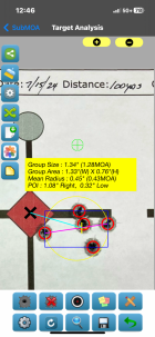

John,
I picked up ten of your bullets at the last Pensacola gun show. I was able to load and shoot them yesterday and wanted to share the results with you.
I shot two five shot groups from a Remington 700 .308 with a 24” 1/10 Kreiger barrel. Both groups were sub MOA as can be seen in the attached photo. The bullets were loaded in once fired Federal cases with 41.0 Grs of Hodgdon Benchmark powder using a Federal large rifle primer.
After talking with you at the show, I wasn’t expecting much in the way of accuracy because you had said you hadn’t had great results out of the .308 bullet. I find these groups acceptable and could probably be reduced with further testing.
Neither group is SUB MOA. Too funny.
