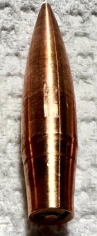

Most likely they are chuck marks. He’s having trouble cleanly parting the finished bullet. So probably chili king them up and turning the base. Makes you wonder how concentric the base to bearing surface to tip is.
This is what the base on all mine look like. If you look at the outer edge of the base, there is a bright circle. So the tail flares, then the base has a slight cup, then the spike in the center.
The tail flare seems diminishing.

This is not a land mark from setting up a dummy round, this is in fact straight outta the box, I received this picture from a well known and respected shooter who's testing the 6.5's.
All I know is if my work that I pride myself in looked like this representation of your work that your so proud of I'd be out of a job and on welfare.View attachment 1575098This bullet should have been recycled not packaged and shipped.
Please don't try to excuse or explain away the obvious flaws as this is YOUR life's work not mine.
This picture is close to the average of ANY bullet I’ve received from Dr. John. Here is a picture of ALL ten bullets from 1 of the 6 bags I have. I will not comment on the machining quality of these bullets, I will simply post the pics and let you be the judge. Take special note of the boat tail shape of bullet #1 versus the other 9 bullets.

A lot of these imperfections may not effect flight, but they point to a lack of quality control and pride in workmanship. You often site 95% confidence level, when a lot of people look at theses bullets, 50% or more of the confidence level has been lost.
More statistics, in a 3 groove barrel, you have equal chances of the jaw marks aligning perfectly with a land or a groove. Those that line up with a grove will not be ironed out completely, those with a land, will. Every other shot will leave varying amounts. Basically any thing deeper than .0005” has a good chance of remaining on the bullet.

Not getting kick at all, I look forward to shooting these. There is just a ton of things that you seem to be over looking that will make a difference on target. When you make statement like I’ve never tested for accuracy, you’ve completely missed the boat.
Here’s another example of lack of quality control, this bullet isn’t even round. It was also a full 1/2 grain light.
How in the world will you prove your point, when there are so many other issues with the bullets?
That’s the whole point of the critique to this point. I’m spending the time to hopefully find enough bullets to prove your idea, instead of simply shooting them as boxed, and calling them a failure.
Then again, maybe you’ll prove everyone else wrong. Your tail design is so advanced, that round doesn’t matter.

Is it optical illusion; or is that bullet's nose and tail completely off axis from the bearing surface?
