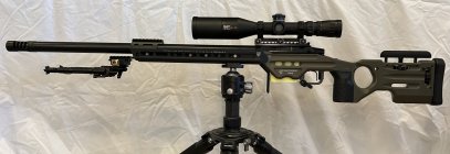

That thing is shooting great! What barrel again?
Its a a Shillen 6.5T on a Curtis Valor action.
