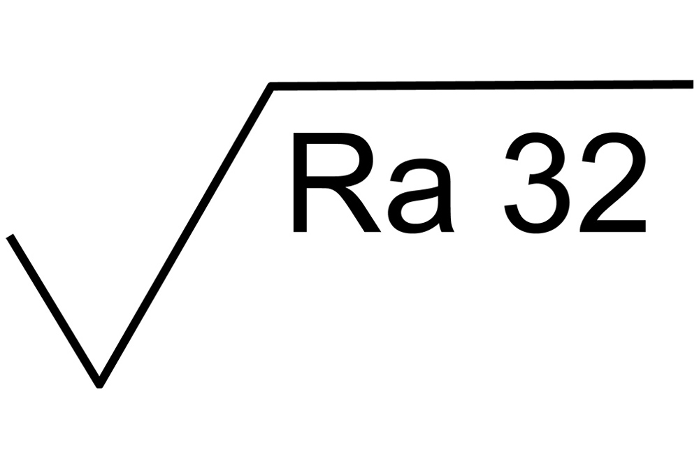

@HappyHellfire , check the surface roughness of your baseline factory bullets and make yours the same. Measure them with surface roughness meters which maybe available at your university. I’m guessing between 8 to 16 Ra.
Not sure what units you are talking but 8-16 micrometer Ra is considered extremely rough. I imagine your units are different. I assume you are talking in terms of micro-inches, in which case 8-16 would be a fairly smooth
As far as the equipment, you can get a basic surface roughness comparator at amazon instead of the expensive equipment use in the labs or by companies with metrology department.
Industrial surface roughness comparators are seriously expensive, way above my pay grade.
I bought a used one of these old-school comparators on eBay for relative pocket change. There's an element of subjectivity using something like this but, once my NASA Space Shuttle contract concluded, I figured what the heck :).
