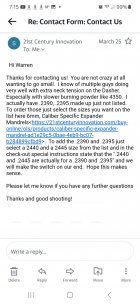

Now I just got into 600-1k yard bench shooting and bought a 6mm dasher from a guy retiring from shooting. So I thought I would test neck tension adjustments, but no one seems to make any mandrels less than .240. Depending on brass, I'm getting. 015-.025 neck tension.
Cortina's company responded to my email saying to adjust bushing size. To it seems like I should adjust mandrel size. I do use amp annealer each firing. I ordered more smaller sizes of bushings but they haven't arrived yet.
Was just curious what others who use expander mandrels do to adjust neck tension?
21st century will make mandrels down to 238 or so. I bushing down to about 237-238 then mandrel up with 240-242 to get whatever seating pressure that works best , using Wilson seater, K&M arbor press and guage.
