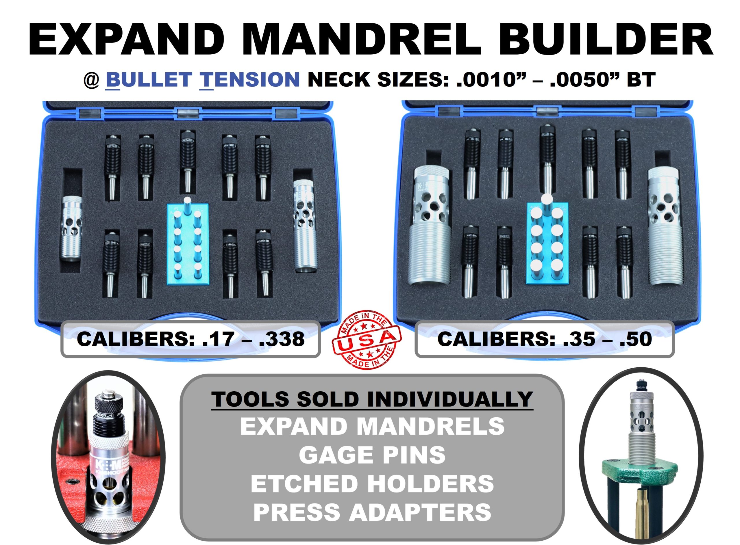

Seems I saw some place a company is making expander mandrels in different sizes in same caliber to control neck tension. Does anyone know who makes these?
That's getting complicated :). IMO, just decide to use either a full length or neck size only bushing sizer die. Measure neck thickness x 2 + bullet diameter and get a bushing to give you 4 or 5 thou downsize to a fired case. Works necks a lot less than a traditional die that sizes the neck more than needed then expands it via the button as you withdraw the case.
I am changing neck dia on my short range guns as well as fooling with 2 new cartridges on my 600 IBS rifles and am currently using a Sinclair style floating die. With my current set up I can use the 21st century expanders but will need at least 12 of them for the 3 calibers. The Porter rig is about half ofthe price or less per expander but it is a ridgid set up and doesn't float. Just wondering what y'all think about ridgid vs floating... John
