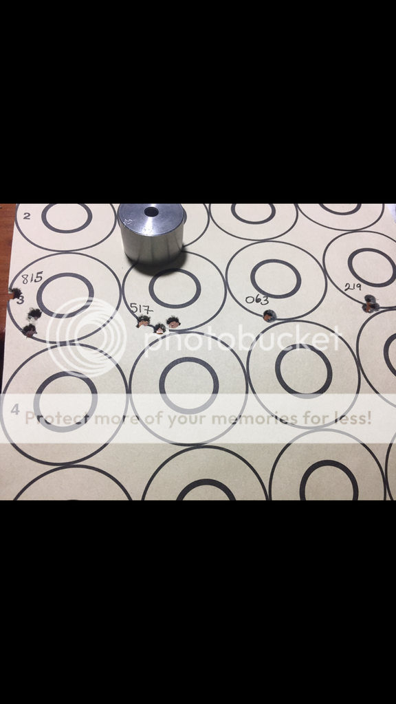

Donovan,
Seriously, there is nothing on your target that would indicate to me that your gun has a proper tune for any yardage. Group 1 is starting to come in IF it was shot at 200 yards.
If I walked up and looked at your target. I want to know what you had loaded. Did you go up on powder for each group were you changing seating depth? If you were changing powder loads each time. I'd Suggest changing your seating depth and try again.
Group 1 needs something
Group 2 same thing
Group 3 you either missed a condition or the guns too hot and popped a shot.
Group 4 looks like you shot in a push and then a reverse. Or the load is horribly wind sensitive.
Group 5 looks too hot.
These are 3 shot groups at 200 yards. Group 1 splattered
Group 2 increased powder but still not right.
Group 3 can't do any better at 200 yards. Probably a fluke!
Group 4 repeated same load as group 3. Load looks like it is working.
With those groups I am willing to make a prediction on dispersion. Now that may not be the load when I go rolling into the range, but that's where I'm going to start. I will normally be at the range in enough time to shoot and make corrections on the load if necessary.
