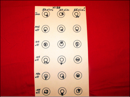

Which load would you choose for a 100/200 yd match? WHY?
I'm with Tom on this one.
James, going from jammed to .025 off how much did your velocities change?

Donovan, I'm going to say trick question they all shoot the same at 1000 and your tune is just that wide with your tuner. Probably wrong but that's my answer
I'd keep them at 5 off and come on the forums and ask wtf a "ckick" is:p
Tom
Tom, this is the method used by HALL OF FAME shooter Jack Neary. He never weighs powder charges, but uses C-L-I-C-K-S on his Neil Jones powder measure. 55 clicks of N133 is a fairly hot load. Did you choose .005 off because it shot dots??? Which powder charge
It seems that the long rangers are very upset by the use of "clicks" to measure the charges. The above picture illustrates a method of tuning by Jack Neary. If any of you don't know Jack, he is a Hall of Fame shooter from Ohio. He is a representative of Vihtavouri powder and he teaches his method at all the big short range BR matches in the country. The reason that "clicks" are used is because Jack never weighs his powder charges. He depends on his Neil Jones measure and observes the results on paper. 50 clicks is a very light charge of N133 with a 68 gr. bullet and 55 is hot.
The above image represents a series of 3-shot groups used by Jack to determine the best seating depth. He looks for a depth that will shoot three different loads into the same relative position on the target. 0.005 inch off of jam does it in this case. With seating depth determined, Jack next tweaks his load with 5-shot groups. He would probably shoot the 55 clicks if it did not show the tendency to be too hot. When a load is too hot, it will spit shots out (normally) low. Good shooting......James
