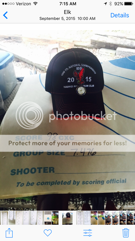

Donovan,
I'm with Jim. If that was the best my gun would shot at 100 yards Id put on another barrel. You may have ended up setting records with it, but it would have never made it to the match.
Here a couple of pics of mine and Dustys targets. These are from the 1000 yard Nationals at Hawks Ridge a couple years ago. We tuned at 100/200 as best we could. BECAUSE that's all we had. Showed up at the range on Friday and set up our reloading gear (powder throw). Needless to say we stuck out like a soar thumb. A couple of dumbass short range guys! At first they had some clay birds scattered on the bank. You could sightin at but really couldn't tell how the guns were shooting. Finally around 2 o'clock for 5 bucks they would put up a target to shoot at. Shot the first target and it was vertical 8 inches. The next target we cut Groups down to the 3 to 4 inch range. Which was about as good as the range would give us for the conditions. By this time we have a crowd standing around us. I heard one guy ask his buddy, "How did they do that?" Up until that time we had never pulled the trigger at 1000 yards.
We didn't do great Overall at the match but our relays got wiped out by an incoming storm. However Dusty and I both managed to Win a relay. Mine for score and Dusty for group. First time out, never shot a 1000 yards before. Tuned at 100 tweaked load at distance.
