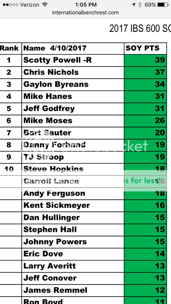

Here's this years point total for IBS 600 SOY. You can add ten more points to my Total after this weekend's St Louis Match from Hell. Looks like Bart might shoot ok at 600 to! I'm not a one trick pony.
