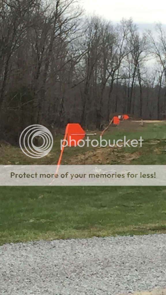

That is a good question. Here's some thoughts on why I think long range shooters believe flags don't work.
First mistake is setting them too far apart. I've done this myself. Say placing them at 100, 200, 300, 400, etc. unless you can figure out a dominate flag that is moving the bullet the flags become irrelevant.
Second, a flag that's 20 to 40 ft above or below the bullet's path is worthless in most cases. It could be a different story if the the range is somewhere wide open.
Third, you have to have flags that you can see. Some guys set them in their scopes. I prefer larger flags that I can see with the naked eye. Dean Stroud was kind enough to make me a set of LARGE flags that you can see at least to 600 yards.
How I use them at different ranges venues?
I'm coming to the conclusion that in most cases less is more for long range shooting. My goal is to give the bullet a good start. I will normally run 5 to 6 flags out to 200 yards or so. At St Louis this last weekend I only used 3 flags stretched out to 150. It was raining so hard I was afraid I'd drown before I got back. At Big Piney I only used two.
How do I pick a condition? Ideally I'm looking for a condition on the flags that agrees with the mirage I'm seeing. So if the flags are holding at a right to left condition I want to see the mirage doing the same thing. Then you have to test on the sighter plate what is moving the bullet. At the very least, I'll use the flags as a go/no guage. If the first 200 yards of flags are blowing right to left and you see a major change in the condition you better stop! If they flip and you shoot and it goes in the group. You just got lucky as hell. The normal result in that scenario is you'll have a shot that's a "Dream Killer."
By watching flags at the first part of the range and mirage at the far end. You getting information on two critical ends of the range. When the bullet is starting out and at the point where its slowing down and vulnerable.
One last thing, I shoot with both eyes open. One watching the flags with the other in the scope.
Here's a pic of my Long range flags. That right there is a nice condition.
