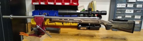

I have been messing with various barrel tuners lately bit commercial and home grown on my rimfire and centerfire rifles and came across a youtube of a guy using a shaft collar as a tuner. A quick visit to Amazon and I had a one inch aluminum collar in the mail. I put it on a Savage FTR with an aftermarket Criterion .260 Remington that shoots consistent .5 MOA groups. I was shooting from a Sinclair bipod and a rabbit ear bag on the rear, Sightron 8 -32 scope. Adjustments to the collar were made using a Starrett dial caliper using the depth rod. Two shots were fired on another target to warm the barrel and foul it. I fired 2 rounds at target 1, adjusted the collar to 2.90 using the caliper then fired two more rounds on target 5 then adjusted the collar forward another .010 inch and moved to target 2. When the first two rounds touched I fired another three. I knew that was a good group so on target three I over adjusted my windage and fired the rifle free recoil. I was pretty pleased with that group so decided to call it good since this is just a FTR rifle. Later this week I will take it back out and stretch the yardage out to 850 and see how she shoots at range.

it's a split collar with 2 hex head screws, you just tighten them where you want it. To adjust you set the dial caliper where you want, in this case 2.080 inches, lock the caliper then place one end against the muzzle, loosen the collar screws and slide to to where it touches the caliper, lock it down. It only needs small adjustments. I started at 3.00 inches and the first 2 shots were horizontal, they began to go vertical at 2.90 and at 2.80 started to tighten up. Next time at the range if the groups start aout horizontal I will go to 2.70, if too vertical I will go back to 2.90.

Sorry for the blurry pic but it should give a idea how it works.

How did you arrive at your starting point of 3.0" in the example?

I just picked 3 inches. As you can see the groups can move go from vertical to horizontal in .010 inches, only very small adjustments are needed. If I keep moving it in .010 inch increments the groups will go back to horizontal then back to vertical. I could have just as easily started at 2 inches or 1.5 inches and still ended up at the same place with 1 to 5 adjustments. That rifle will shoot .5 to .75 ten round groups at 300 to 800 using 44.5 grains of 4831 SC and a 140 grain Barnes Match Burner seated .025 to .030 from touch when I do my part. I am hoping this will knock .1 or so off that. Bear in mind I do not consider myself a great shot, or some kind of firearms expert. I just do this as a hobby
edit - as I pointed out in a earlier post, just from what I have see a tuner will not get a 1 Moa load down to .5 MOA but it may help you get a .5 MOA group down into the 4's or 3's. Just my opinion as always your mileage may vary. In the OP pic the exact same load went from .46 to .3 just by me concentrating a bit more on my technique and trigger control. The whole tuner thing just might be mental, but for 7 bucks it is a fun experiment
