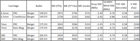

The design was sent to SAAMI and there are only a few in the hands of the early adopters for testing. I caught a video review on YouTube by gavintoobe where he shows two rifles he put together for the new cartridge and shows some numbers that I used for a perspective. I used his energy levels to balance an identical bullet for each of the PRC designs and just threw in something close for each one just to have a side by side.
Don't take these too serious since anybody could use a longer or shorter barrel or push the pressure up or down a little on their favorite, but here are some values from his video and a chart I threw together for perspective on how the new PRC compares to an available option.

And here is a little perspective chart I threw together based on rough values for approximate energy values by comparison.
I used a middle of the road muzzle energy value for the 7mm Mag just to show a perspective, and it would be hard to know if the values for 7mm PRC are inflated or typical. On the upside, it sounds like it may be a decent belt-less cartridge to work with if the brass gets adopted by a high quality manufacturer like Lapua. Only time will tell. YMMV
