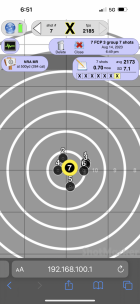

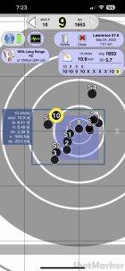

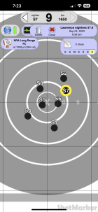

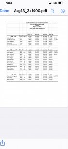

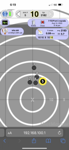

The 7FCP did great for me yesterday. I chambered a 8.5” Blake barrel Thursday, did break in and some light load development on it Saturday. I took it to a 1K club match Sunday with 64 rounds on it and won F Open. Still needs some tuning but it definitely has potential!
Got 40 rounds thru the bbl. 2724 avg MV with an SD of 3.1, shooting 54.4 Gr N555 under 190 Berger Hybrid. Brass appears to have FF good. Going to strip the bolt and see how it feels.

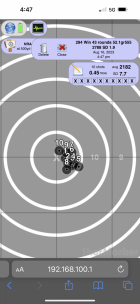

Shot off the bench today, mirage was terrible on ground.. Wind was 8-12 at 8…
All the top shot marker targets are the 7FCP.

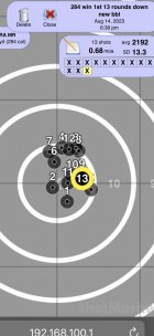

Bottom shot marker is the 284 win with a new 32” finish Bartlein 5R 8.5 T that now has these 13 rounds down the bbl,IMG_0720.png

The 284 win is chambered identical to the bbl I pulled, freebore and head space. The first 13 rounds down the bbl with a proven load hammered as seen on shot marker.. that is so close to being polished. The 7FCP will be there by the end of the weekend.

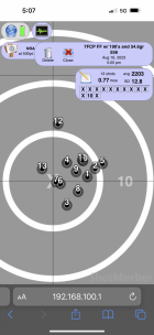

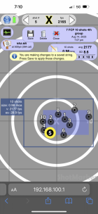

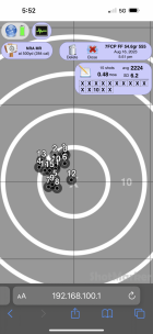

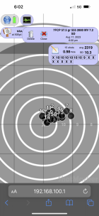

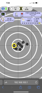

Settled on 57.5 gr N555 Avg MV 2884 with SD at 4.3 w/ Berger 190’s. The wind was steady from my 9 today. Don’t read anything in the horizontal wasn’t holding for it. I’m 100% sure this wasn’t anything but wind, hardly no vertical. Will shoot it again to confirm.
1st Shotmarker is the 57.5 gr and rest are just FF…IMG_0740.pngIMG_0730.pngIMG_0729.pngIMG_0731.png

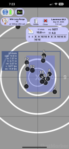

Colorado was a great time. I had shot 200 FF rounds and 35 formed rounds of semi tuning thru my FCP prior to heading to Colorado.
Did a quick tuner test after arriving in Colorado at 200 yds. Took a while to get it back in tune, big difference in DA and temp here.
The FCP did its part, I didn’t.. shot clean 1st match w/ 11x and ended the day with a 577-17.
Weather and wind didn’t play well…
Going to spend a lot of time tuning when we get back home and get it ready for Louisiana State next month.
