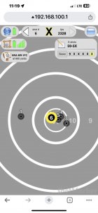

This 7FCP has definitely come through for me….I have much confidence in it…The flyer on the left was me having the rifle move in the pocket….wind was approximately 7 mph.
This was at 600 yards and won me the match.
