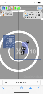

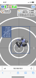

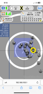

(same reamer) with no issues and I’m keeping an eye on them. I’m really only squeezing them an extra 1 or 2 thousandths. Erik’s smaller die works with the .535 chamber. I think he’s maybe running high 2900’s is why he’s exploring other methods. I’m right around 2900fps. This is Lapua brass we’re talking about also. I wouldn’t go trying to hammer on Hornady.
