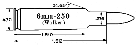

That looks a lot like the old 6mm International (Michael Walker's take on the 6mm-250) but with a slightly longer body and less body taper.
https://loaddata.com/Cartridge/6mm-250-6mm-International-Walker-Version/3766
Fourth from the left.
https://www.shootersforum.com/wildcat-cartridges/102901-6mm-wildcats.html#post867543
