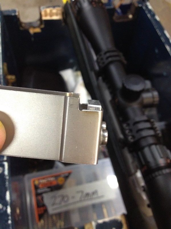

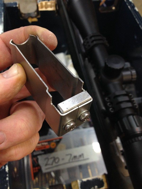

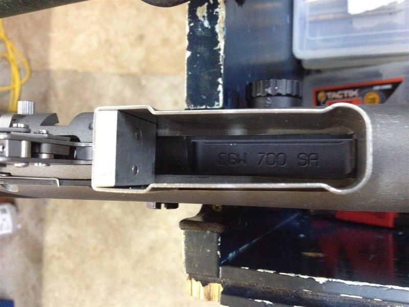

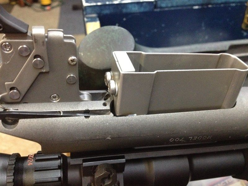

I have experienced problems with feeding with my modified magazine. I have removed the 223 spacer to give my full 308 mag length in the standard Remington magazine. I modified a 308 magazine spring to hold a 223 follower at the rear of the magazine, but I am having problems with bullets jumping out of the magazine before the projectile hits the ramp designed to lift the front of the bullet up.
I am in the process of making a half thickness spacer and will go back to the 223 length spring to try and give better forward support to the bullet as it slides forward in the magazine.
I want to get the standard magazine working as a detachable mag setup would get in the way of my hand placement during offhand shooting.
Hell... I like it soooo much, I even sold my .222
Edit.... next step is to get the 80gn Berger's I have shooting with some slow burning powder, ADI 2206H which is the equivalent of 4895. I foresee compressed loads :D
Today I got the spacer made and installed. I used a piece of aluminum for the job.
I cut a piece the same size as the original spacer only its about half the thickness. This gives me more magazine length but I can go back to the 223 size magazine spring for more forward support in the magazine.
I drilled 2 holes in the back of the mag box and drilled and tapped the new spacer. There is plenty of clearance for the 4mm screw heads inside the stock.
My loads fit in with about 2mm clearance so its perfect.
Also, going back to the 223 spring allowed me to go back to using one of the old school Remington cast magazine followers which is curved and shaped to the case, and IMO, just better than the nasty stamped modern one I was using.
I made 3 dummy rounds and cycled them through several times with zero feeding issues. It was definitely more reliable than before when cycled fast and slow.
