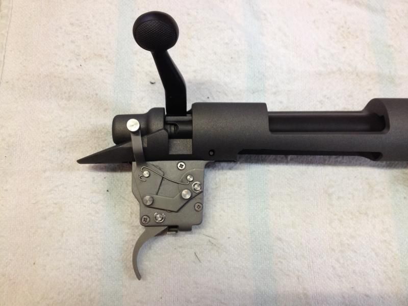

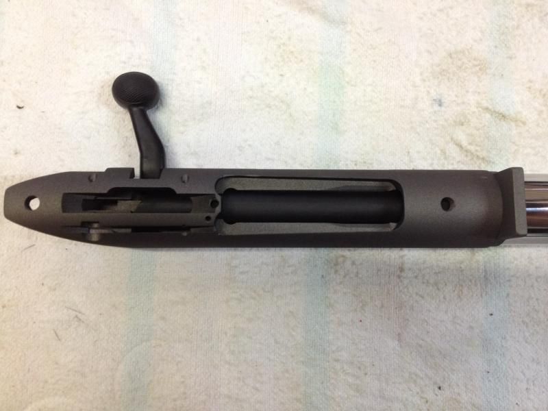

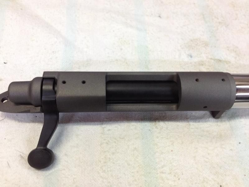

I have received a couple of PM's recently asking about the progress of this build, and with a smile on my dial, I picked it up today.
I had the action cerakoted in Titanium, and the bolt done in black micro slick. The SS Krieger has been polished...... just because i like shiny stuff 8)
I put the bolt back together, and fitted my Jewel trigger
I then dummy fitted it all up to the stock, fitted the rail and scope to make sure everything goes together without any issues. All i had to do was remove about 1 thread from the front action screw which wasn't original to this rifle.

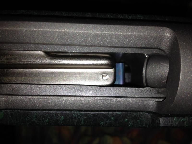

I made up 3 dummy rounds to test the mag and feeding for rapid fire comp courses.
It Feeds perfect, but the bottom of the feed rails need polishing up as there is a sharp edge scratching the cases somewhere.
You can see in the picture below, the magazine has had the 223 spacer removed and is now using a modified 308 magazine spring holding the 223 mag follower at the back of the magazine. This will give me all the room i need to seat my projectiles as far out as required without having to worry about magazine length.

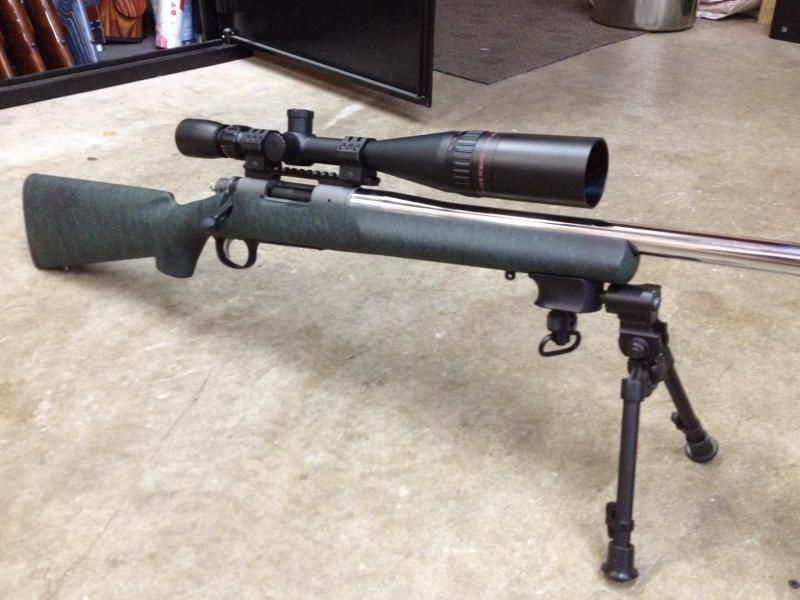

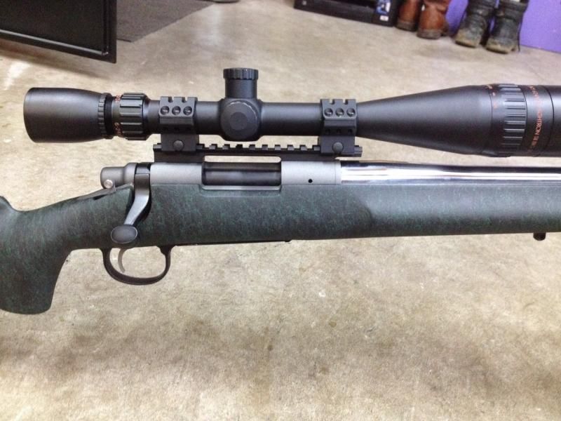

Pics below of how the final product will look.
EGW 0 MOA rail and Weaver rings holding a Sightron SII Big Sky 6-24 scope.
Stock is off a Remington 5R Milspec 223 and will work perfect for what i want to do.

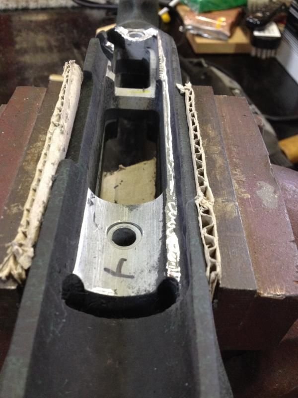

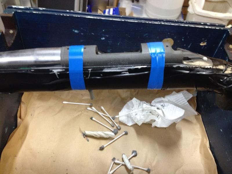

I stripped the rifle back to bits again today and prepped it all for a dose of Type F Devcon.
Taped the bottom of the action and put the blind bolts in with tape to align the action in the pillars. Coated it all in polish and put it aside.

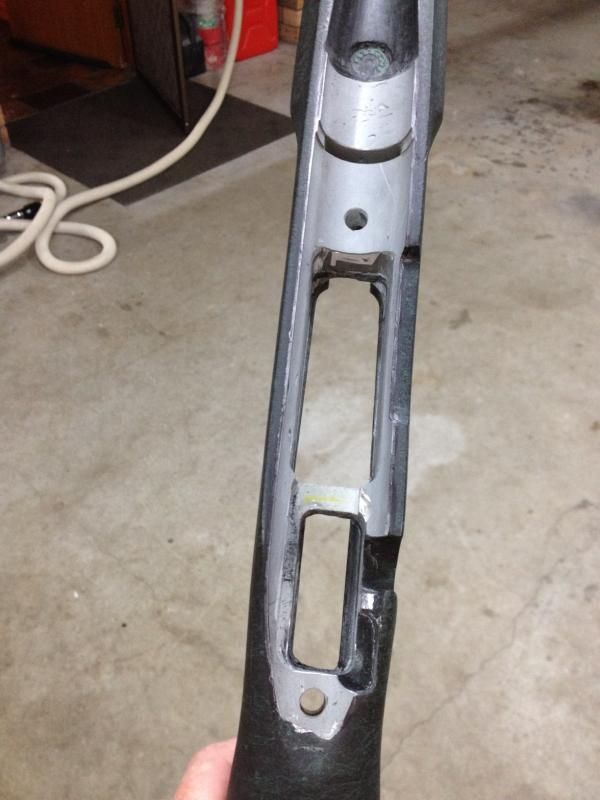

I then took to the stock with a dremel to remove material and make way for a good solid bed.
I removed some of the black plastic along the side rails of the alloy bedding block

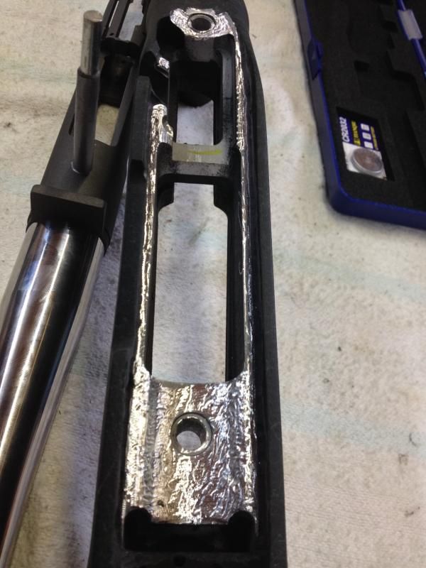

I then took some material out of the front and back of the main action seating area making sure nothing was touching anywhere except the little bit at the rear used for height reference. I also drilled some holes 3 to 5mm deep to act as pillars for the bedding, adding structure and strength.
I was drilling some holes in the black plastic stuff the stock is made from, where i planned to extend the bedding under the first inch of barrel. I noticed it was a hollow in the alloy block full of plastic. Not wanting to bed on top of plastic, I hooked in with the dremel again and cleaned it out, planning to fill it with Devcon to add strength to the bedding under the barrel and action, bonding it directly to the alloy block in the stock.
Mixed up the devcon, slopped it in, yada yada yada....... now for the long wait to see if it comes back out!

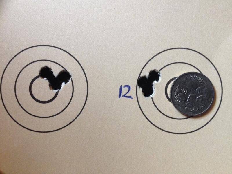

Started with a mild load and worked it up 0.3gn at a time. Accuracy was average with 0.75" groups until i hit a load that I would call safe max as the primers were flattening out.
groups are 0.25" which will do me
I also found a reduced load with 7gn's of ADI AS30N (same burn rate as red dot) with the 70gn TNT's and we ran them over a chronograph for 1720 FPS. A perfect mild load for rapid fire comp stages!

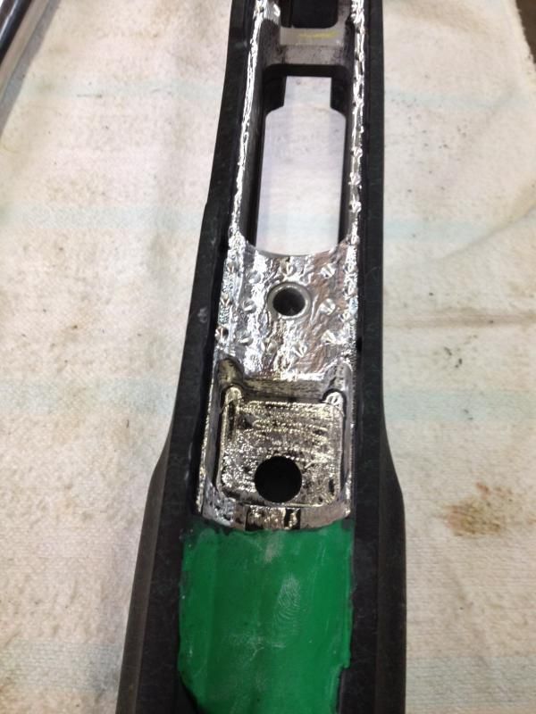

Bedding photo.
There were a couple air bubbles under the barrel which cheesed me off a tad but it wont affect anything.
I ended up with a perfect full length bed from 1" down the barrel to the back of the action, all bonded to the stocks integral alloy bedding block. Before i bedded it, the action only touched in 4 small places with very little contact surface.
Used Type F Aluminum Devcon
