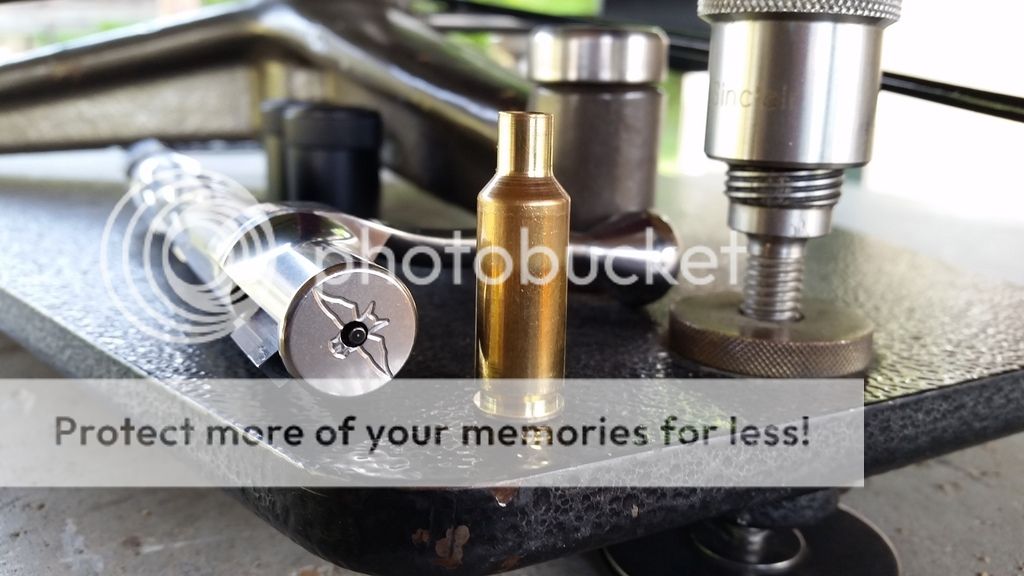

I used what I had on hand to jump in on Sam Halls inspiring new case. I took a barrel had been chambered and never fired, moved the shoulder .070" and ran my BRDX reamer in to have slight pressure closing the bolt on 6BR go gauge so no galling to worry about. Placed a new 6BR case and measured how much had to be trimmed. A 1.524" OAL is max length. The fired case draws up .007". Sometimes us old timers have too much fun.
Here is a fired case to see the BRDX neck length on the BR-AI. Mr Ackley had the right idea to use .004" crush on the less consistent cases of his day, and for sure most AI versions came from cases with low angles. The consistency of Lapua brass, and the combined 30 degree angle was concerning using .004" crush. I used a slight resistance on the BR gauge and all went super. That would be 1/2 to .001" thousands crush.

Hey Phil, yes I used a BRDX reamer so I would have that neck length, but used a 6BR headspace gauge. I knew this would cause a shorter OAL, but is exactly what I wanted. It is a 6BR improved with a BRDX neck. Trim OAL to 1.514" gives .010" clearance. I first trimmed to max length of 1.524" and upon firing the cases shrunk .006" to .007". Turned out a very easy to look at case.
I initially had .004" crush, and had the option of using my 6BR FL die to reduce crush, so I bumped the shoulder of a new piece of 6BR brass back till it fit the chamber perfectly to my liking, then using a bump gauge from a barrel stub, I compared this fit to the factory case and it was .004" difference. I put the barrel back in the lathe and took the reamer in another .0035" on the Lambeth/Kiff micrometer stop. I now get slight bolt pressure on closing the bolt on a new case. No worry about galling, and all 40 pieces fired beautifully. I was jumping 108`s .020" and never missed a beat. This reamer has a tapered neck from .271" at mouth to .272" at shoulder so I cleaned up with light turn of .0122" to give .003" total clearance, with .266" bushing I get .002" tension. NOW, if I can just figure out how to get it to shoot like James`and Sams barrel!!!!! Its a Bartlein .237" 4 groove 8 twist. It is liking N-203B at first glance.
