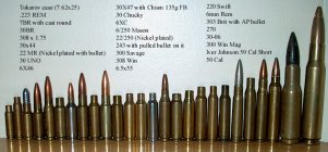

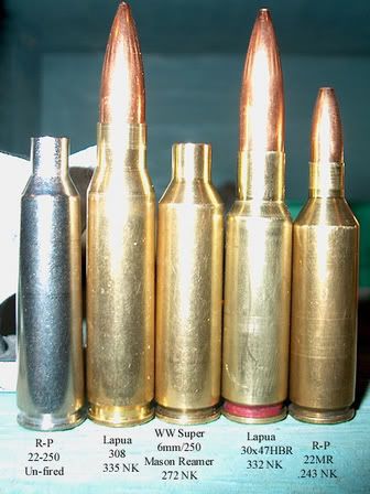

Samuli, I have a 22BR with a .243 NK run in .300" deeper, called a 22MR,,7th from left) which is a 22x45.7708mm. A friend used a 6x46 in Hunter Bench Rest using 308 brass,9th from left). He said it shoot pretty good but moved to a 30 for the hole size,score comp).
I'm making a new rig on the 6mm/250 Mason,13th from left) which is a tad bigger than a 6XC, both of which you can think of as a 6x48 + a hair. I also use a 30x47 in HBR,10th from left), necked down to 6mm it would be plenty of zip too.
I would go more like 8 or 9mm deeper,6x47 or 6x48) if you want the extra zip using the heavier bullets, IMO.

RickB,
You are right, the 6mm/250 has a shorter neck than the 6XC but a little longer wider body and holds 1.4g more water.
,Used soap water to lessen/disburse the surface tension of the water)
The 6mm/250 made on a W-W Super 250 Sav case holds 50.9g of water, empty weight was 157.3g with a primer in place, full was 208.2g
The 6XC I have, made on a WIN 22-250 Rem case holds 49.5g of water, empty weight was 162.1g with a primer in place, full was 211.6g
A full 308 has 56g case cap and my 30x47 has 49.49g case cap made from Lapua 308 brass.
The 6mm/250 has a .469" base and a .466" body base above the extractor grove and a .455" body at the neck/shoulder area.
The 6XC has a .468" base and a .466" body base above the extractor grove and a .450" body at the neck/shoulder area.
Both have the same shoulder angle as a 6BR, 30 degree.
Thus, the 6mm/260 has less tapper than the 6XC, i.e., more blown out, and is a hair longer in the body, so the case cap. is a little more than the 6XC.
kds
