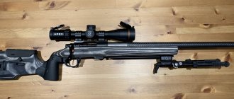

This is a .45 cal Arrowhead ML but I changed the ignition system to a Hankins. I also restocked it with a McMillan HTG stock and in doing so I used a Hankins rod retaining block for the ramrod. It all works great. It's a smokeless ML but I've never used smokeless in it. I run 113.5 gr of Blackhorn behind a 327 grain Parker Black Max at 2450 FPS. With the custom funnel, you can pour the powder and start the bullet through the brake. As you can see, it shoots pretty good...
