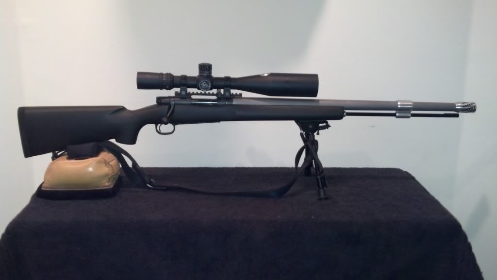

Here's one built on a Winchester Heavy Varmint. I built it with a 24" barrel and a 3.5-15x50 N/F.
I'll try to post more pix and info when I get a little more time, next week.
Nice looking rifle Jay,...I am glad this thread is back alive, some very good input from people today.
