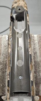

I just finished this rifle up. I used a Mesa muzzleloader action and a Mesa stock. Barrel is a 26" Brux heavy varmint contour. Hankins ignition setup and brake. Bix n Andy tac sport pro trigger. Overall a real nice setup and it came in just over 10 pounds which is not bad considering the barrel.DSC_0318.JPGDSC_0319.JPGDSC_0320.JPGthumbnail (3).jpg

I can't wait to see how it shoots.

Beautiful build!! Wonder how long it’ll take some fool read that, then dump smokeless powder in their 45 cal smokepole. Survival of the fittest I suppose

Early on, many were built on 700ml actions. I have one and it will shoot .1s at 100. My first smokeless was a Savage MLII purchased when they first came out. It was before it’s time. It is not as accurate, but holds 1/2 inch at 100 and made black powder obsolete for me.

Alex can explain this better than me, but using a centerfire action has advantages, and if I were having one built now, that is what I would use. The Mesa is a centerfire action that is specifically set up for muzzleloader. Slick actions. I would love to have a .40 cal. “tote” muzzleloader built on this action.
