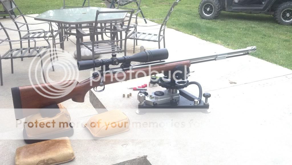

Custom 40X Muzzle Loader
I'm not trying to hi-jack yer thread but I had these pix over in the "show off your s.o.b." thread and thought I'd post them here since you brought this up.
I built this one last fall, it has filled several tags but nothing over 240 yards. I shot a doe in the chest at 175yd and the bullet went all the through and out the back end, I have yet to recover a bullet.
I'm shooting the 325 gr Parker with an Ox-yoke "Wonder Wad" over 72gr of IMR4198. The load data for the 458 Winchester looks about right for most of these rifles, my load produces velocity right in the mid range of a 460 Weatherby with 300-350gr bullets, these are "extreme" muzzle loaders.
I'm planning another build on a Win70 action with a shorter barrel soon, I'm contemplating selling this one.
Here's some details...
Krieger 1-20 Twist barrel 29" long.
Modified Harrells aluminum brake.
Jewell trigger
Burris Tactical Rings & Bases
Sightron SII 4-16x42 HHR

HI Jay.....nice work....is the lil funnel to prevent powder from escaping thur the muzzle break while loading.??...and how do you keep the powder from running out the breech without a primer/brass in place....just curious....wow these things have .458 power!!!.....lots of folks around here use muzzle loaders ...and I am thinkin of something like this...any info would be apreciated....Roger
My rifle has a breach plug and a nipple just like the commercial muzzle loaders. I use a shortened lapua 243 winchester case with a 215 fed for a primer.
The plug, nipple & case together as an assembly are headspaced so there is enough pressure to seal the nipple directly against the brass primer holder. I get no gas leakage what so ever.
The primer will flatten out under pressure just like a center fire.
Its a good idea and it makes for a safe rifle.
