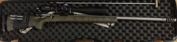

IMHO, 70 is a hot load. I'm using 63.5 of H4198 and CCI mag primers and the 275 Pittman Accumax. Chrono MV is 2735. Zeroed at 100 meters, drop at 500 meters is 16 moa, 1100 ft. lbs at 650 meters. Below is a test session that landed off the paper with that load at 500 meters, a skosh under 3", three shots. I have a bud who shoots in the 70 gr. load regime and he told me it pounds him. I have an MBM 5 port Nathan bored for a .45 ML and a RAD. I'm a lightweight but can still shoot it with a T shirt.
Edit: I size the bullets .4502

Great gun! I like the barrel contour much better than any others I’ve seen.
I never thought much about muzzleloaders, but the lines of this rifle remind me of a safari gun. I can totally get excited imagining a blued gun with express sights, banded barrel sling stud, and old school wood stock.
