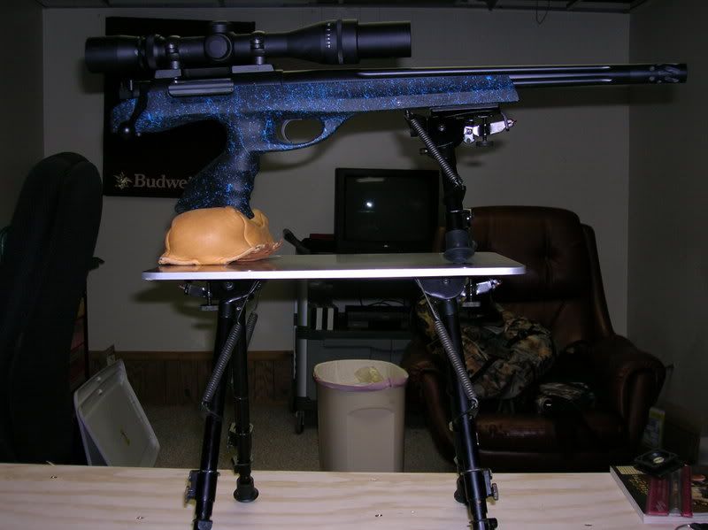

I'm a High Power Long Range shooter. I use 58.0 gr. of H4350, CCI BR2 primer, Win. case, and a 220 gr. Sierra bullet soft seated. Rifle is a Remington 40X solid bottom in a Master Class prone stock with a 30" Krieger 1:9" twist bbl. I managed a 199-9X in the Wimbledon Cup at Camp Perry in 2006 including a 100-7X on the first string.
The excellent metal work was done by Warner Tool Co., and the excellent stock work was done by Alex Sitman at Master Class Stocks.

How much does your gun weigh and how is the recoil??
Tony,
It weighs 16 pounds with the scope. Recoil is STOUT with the 220 Sierra. Significantly less with the 210 Berger. Seems that way, anyway.
Jeff

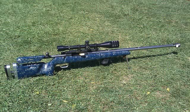

I'm shooting a clunker small shank savage 300 wsm "cardinal Sin". 30inch Criterion 10 twist bull that wad a 308 barrel for about 15 shots. I shoot 200 gr smk with 72 grains if H1000 with wolf lrm primers and its a hammer. I have it in a master class stock and a Sightron SIII 10/50/60 FINE crosshairs. it does shoot really well I also will be trying N170 tomorrow with the 208 and heavier. I havent tried 4831 but ill try that soon also. I will be getting a muzzle break soon just to make it more pleasurable to shoot

The answer is no, a 10" twist will stabilize the heaviest bullets at .300 WSM velocities. A 12" twist is only good up to medium weight bullets. I have a 10" twist .308 tactical rifle that shoots Berger 155.5 Fullbores very well. Stick with the 10" twist.
