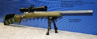

Forum Boss, 1st let me say hello to all. I've been shooting \ reloading for long range rifles for almost 30 years . I have a Win. M70(SS) in 300 WSM that I mounted a Lilja 1:10 barrel on cut to 22". I planned to use the rifle for both hunting & target shooting thus the 22" length. The barrel is fluted with a varmint contour and I placed this package on a H-S Precision medalist stock then topped all that with an IOR Valdada 2.5-10 x 42MM that has an MP8 Modified Dot Reticle. After working on loads for several weeks and shooting 20 or so test rounds each outing I did find an excellen accuracy load. The load data is:
Hornady A-Max 155 Gr.
Re-22 @ 71.4 gr.
Norma Brass (Sized to ensure 2.100" OL, Neck sized & de-burred etc.)
CCI-LR Magnum Primers
RCBS FL Sizing die
RCBS Comp. Seating Die
COAL = 2.910" (approx. .005 off lands)
I've only proven the accuracy of this load out to 200 yds. but three shot groups @ 200 yds. look like one ragged hole. I'll be taking the next tests out to 500 or even 600 yds. then to 1000 yds. afterward.
